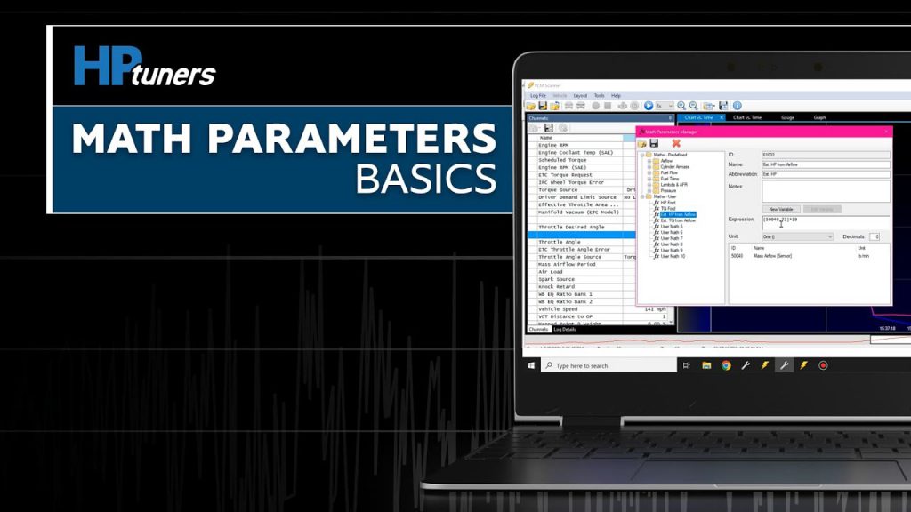

What Are Math Parameters?
Math Parameters let you create your own virtual measurements inside VCM Scanner. They combine existing channels (like commanded AFR and measured AFR) into a new value that you can log, graph, or chart alongside the factory data.
Think of Math Parameters as a calculator built into VCM Scanner. Instead of exporting your log to a spreadsheet, you can do the math right in the software—live, while scanning or during playback.
