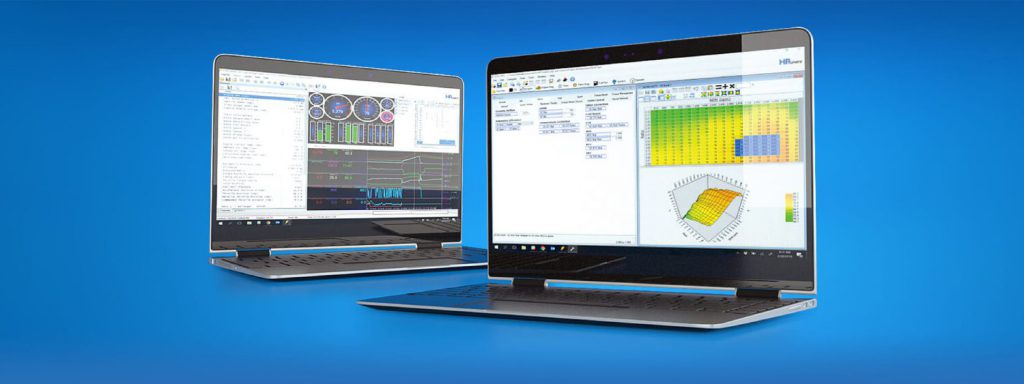

Two Laptops Displaying VCM Editor and VCM Scanner
